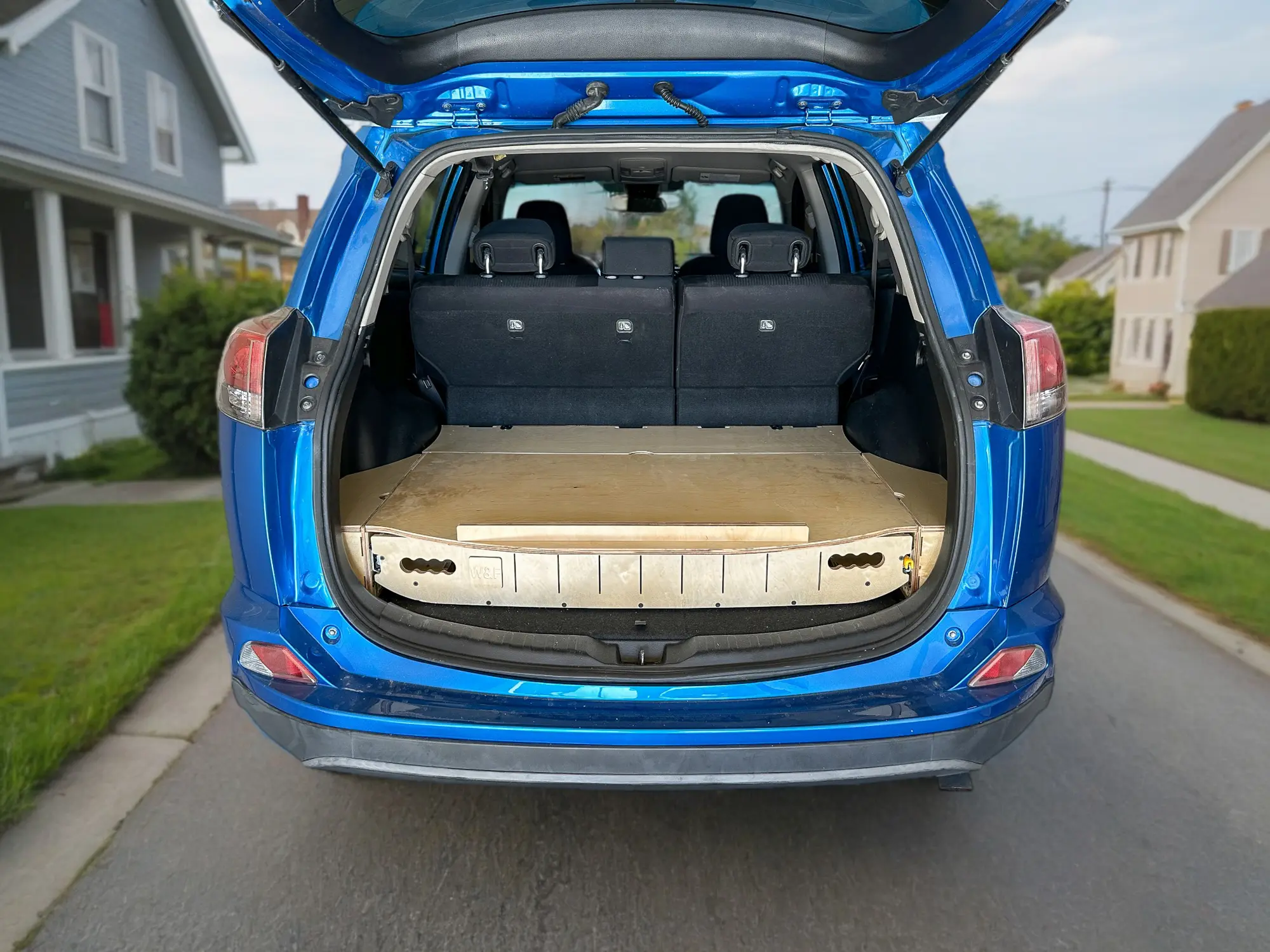

    Buy the Storage Drawer System for Toyota RAV4 (2013-2018)
    The Storage Drawer System helps you organize your trunk space. It makes everyday car use and long trips more convenient and enjoyable. Turn your city crossover…
    wheelsfeels.com
